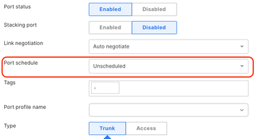

Is it just the link going down or the whole switch? Make port scheduling isn't enabled on the port.
