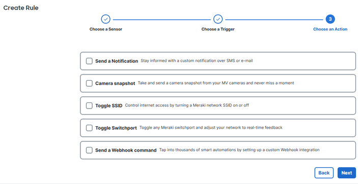

Hi, sounds good. Do you know, If it's possible with the MT30 to disable only the AP in the classroom,while other AP's are working, so that every teacher can control the AP in his classroom. SSID disable ist nit a good Idea,because of 60 classrooms,but only 16 SSIDs possible. Not possible to get all classrooms with different SSIDs
I believe you can turn switch ports off and on.
cmr
@Holli69, you can definitely do that.  I have used that feature for years, mainly to disconnect my daughter's computer from the internet when she was a student and up late!
cmr
That will disable whatever (the AP in your case) that is connected to the switchport.  you can also send a webhook command to do pretty much anything you like.  You could use this to add or remove a tag from an AP and have the student SSID only active on APs with the tag.
