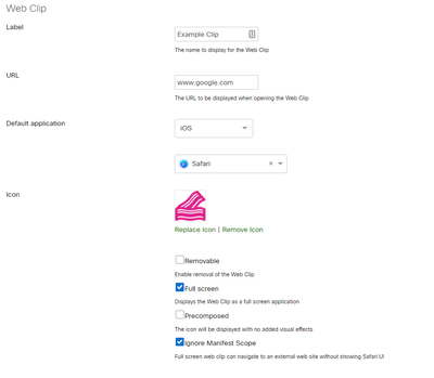

Hi,
I'm trying to setup some web clips to show on Supervised (DEP) iPads.

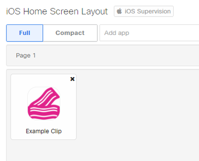

The clips don't show up on the device anywhere for a user to use. I've then tried to add a home screen layout, as these devices will have a few hand picked apps on them only (Kiosk like devices). Here are some screenshots showing my config. Interestingly, Settings -> General -> Device Management -> Meraki -> More Details shows the clips, so I'm not sure why I can't then use them.
Can anyone point me in the right direction to get this sorted?
