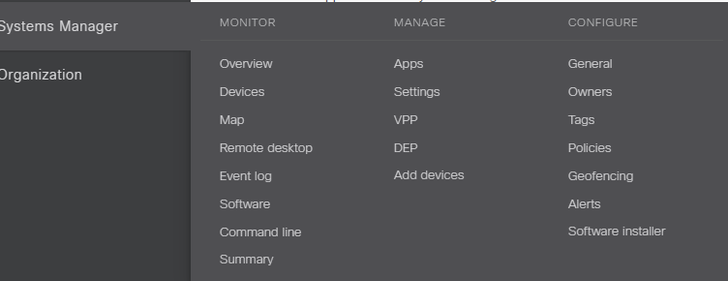

@cteaglesfan
Do you show any devices within System Manager - Manage - DEP?
If not something is not quite setup right. Here is the document from Meraki on using DEP.
https://documentation.meraki.com/SM/Device_Enrollment/Apple_Device_Enrollment_Program_(DEP)
I suspect there is either a breakdown in communication between Apple and Meraki or there is something with how the devices were purchased that is breaking the automated import into the Apple Business Manager portal which is not allowing the devices to flow into Meraki.
