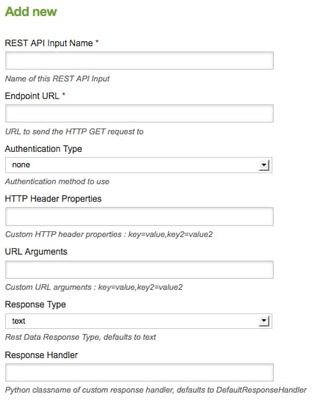

HOWEVER, whilst not impossible, there's a little work for you to do. It looks like Splunk can ingest data using any REST based API:
https://www.splunk.com/en_us/blog/tips-and-tricks/getting-data-from-your-rest-apis-into-splunk.html
And this starts with a simple form to fill in:
Don't forget that Meraki uses a custom parameter for Auth,
X-Cisco-Meraki-API-Key: <secret key>
Which should go into your headers.
