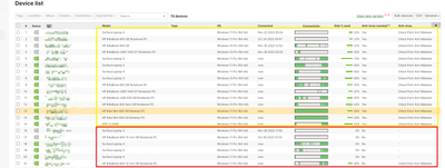

For quite some time now, Meraki MDM is showing "AV Not Running" on several Windows machines:
HP EliteBook (840 14 Inch G9) and Surface Laptops (3,4 and 5)
Would you be able to tell me if I'm the only one with these issues, is it a known issue? Have you been able to resolve it? support has not been able to help us with that so far.
I'll really appreciate your response on this.
Thanks

Our entire AV protection is under CheckPoint Harmony Endpoint AV. weird enough some of them are marked as AV installed, some are NOT but all of them have the AV, from the AV portal site are all operational. i don't know if theres something to do with the type of machine (surface X and Hp EliteBook)

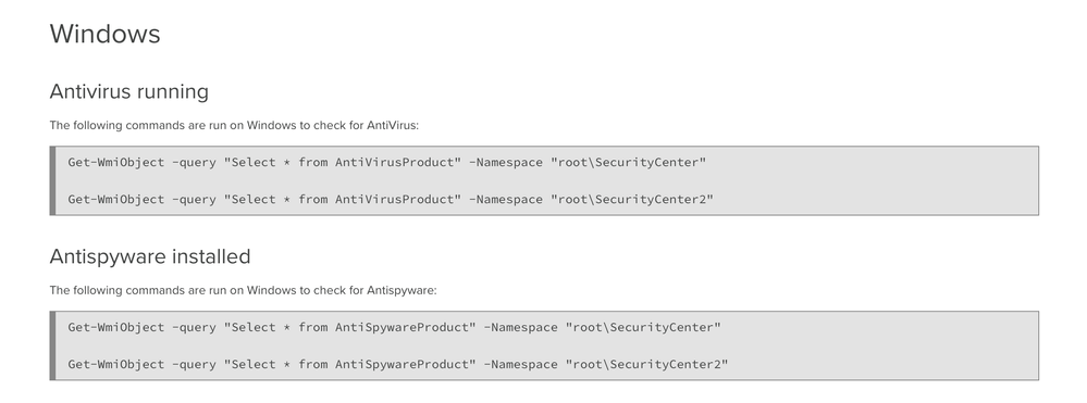

@ETC-DanielL My guess is its either the version of OS or version of AV. I would open a support ticket and see if that AV software is compatible with systems manager
The documentation states this is how SM checks to see if AV software is installed.

Is so strange that all the other machines registered OK with that AV. The problem is with the ones in red.
For the last one I just completely removed and installed CheckPoint again and still shows as NO AV Running but registered the AV.
Support have been engaged in the past for the same situation and were not able to help. that why I'm trying to check from other sources if anyone else has encounter this issue in the past.

And one of the commands for AV check is returning that checkpoint is present:
PS C:\WINDOWS\system32> Get-WmiObject -query "Select * from AntiVirusProduct" -Namespace "root\SecurityCenter2"
__GENUS : 2
__CLASS : AntiVirusProduct
__SUPERCLASS :
__DYNASTY : AntiVirusProduct
__RELPATH : AntiVirusProduct.instanceGuid="{5E1A3CFB-A963-5D99-A23F-7BA03B432F37}"
__PROPERTY_COUNT : 6
__DERIVATION : {}
__SERVER : x
__NAMESPACE : ROOT\SecurityCenter2
__PATH : \\x\ROOT\SecurityCenter2:AntiVirusProduct.instanceGuid="{5E1A3CFB-A963-5D99-A2
3F-7BA03B432F37}"
displayName : Check Point Anti-Malware
instanceGuid : {5E1A3CFB-A963-5D99-A23F-7BA03B432F37}
pathToSignedProductExe : C:\Program Files (x86)\CheckPoint\Endpoint Security\Anti-Malware\epam_cli.exe
pathToSignedReportingExe : C:\Program Files (x86)\CheckPoint\Endpoint Security\Anti-Malware\epam_svc.exe
productState : 266256
timestamp : Thu, 30 Nov 2023 18:59:04 GMT
PSComputerName : x

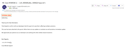

I found this ticket from some time ago from a colleague of mine who faced the same issue (Case 09389282 AV not Running 1) and it seems there's a general issue with this. I don't know if there's any from support here that can help me to know if this is 100% accurate and if there are any updates.
