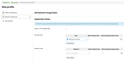

So, I see that you have iOS tagged, which makes this relatively straightforward. You'll need the Network Usage Rules setting
 This should work perfectly for your use case.
Lburk
I'm testing this now on a few devices to make sure no other issues crop up, but this does seem to be the way. Thank you!
Lburk
I've been testing various device and this works PERFECTLY. If the device isn't connected to WiFi the apps in question will not work. Just what I needed. Thankyou. Now though, I have a follow-up question if I may.

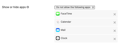

A security policy doesn't prevent something, it only allows you to show devi cos which are compliant / non compliant against this policy.
What you need is a Restrictions profile. Under Show / Hide Apps, you can add your app(s) here

Lburk
So by setting the policy as I stated above, it should then show me if someone is going to certain websites? Is this correct. I setup the network usage as you suggested and it's working perfectly. I'm just trying to cover my bases and curb the abuse we're seeing. Thank you once again.
PaulF
Meraki Employee All-Star
It won't show you who is abusing data. It will just prevent it.
