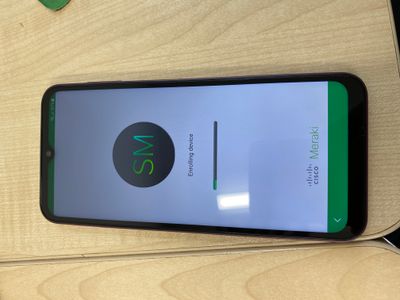

So I dipped my toe into the management of Android devices this morning, I have been managing iOS device using SM for years but never Android.
So everything is setup behind the scenes in Meraki and Google workspace and everything looks happy. The problem is I have just gone to register the first device and scanned the QR code as well as signed into the appropriate Google account and now I have this stuck on the screen with the progress bar getting to the end and then going back to the start and the device now appears to be stuck in a loop.
Any ideas or have I made the mistake of trying to manage Android devices 😂

UPDATE restarting the device and giving the SM app write access to the couple of things fixed the issue. Off that it didn't ask for that before trying to enrol but it's working now.

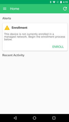

What I found is this screen as well as having the enrol option also has two other options, one related to permissions for writing to the device and I can't remember what the other is ( I will take a picture next time)
If you don't allow write access thats when it gets stuck in a loop.
