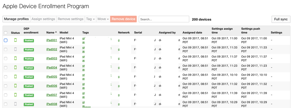

Please take a look at the following screenshot:
Why is the "Settings" column blank for all of them?  (FYI, the "Settings" column is not blank for the one that I assigned the new DEP Management Profile to.)
How could we have received a bunch of iPads WITH NO SETTINGS?!!!  Is that why I cannot pair with AC2?!
PLEASE HELP!!!
>need to get Apple Configurator 2 (I'm gonna call it AC2) to connect to my managed iPads.
I was under the impression this was meant to be mutually exclusive.  You can use one or the other.
@jared_f might be able to help.
