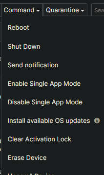

Do you not get the option in the devices page under command?
This should allow you to select multiple devices and erase them at once.

JT5
See, that’s the thing.
Even if the current iPads were Assigned or not I don’t have a way to communicate with them especially for a factory reset command.
Does that make sense?
