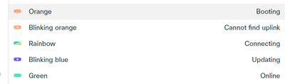

Also pay attention to the status LED on the front of the GR10:
If this doesn't work, file a support-ticket and have Meraki-Support look into it.
