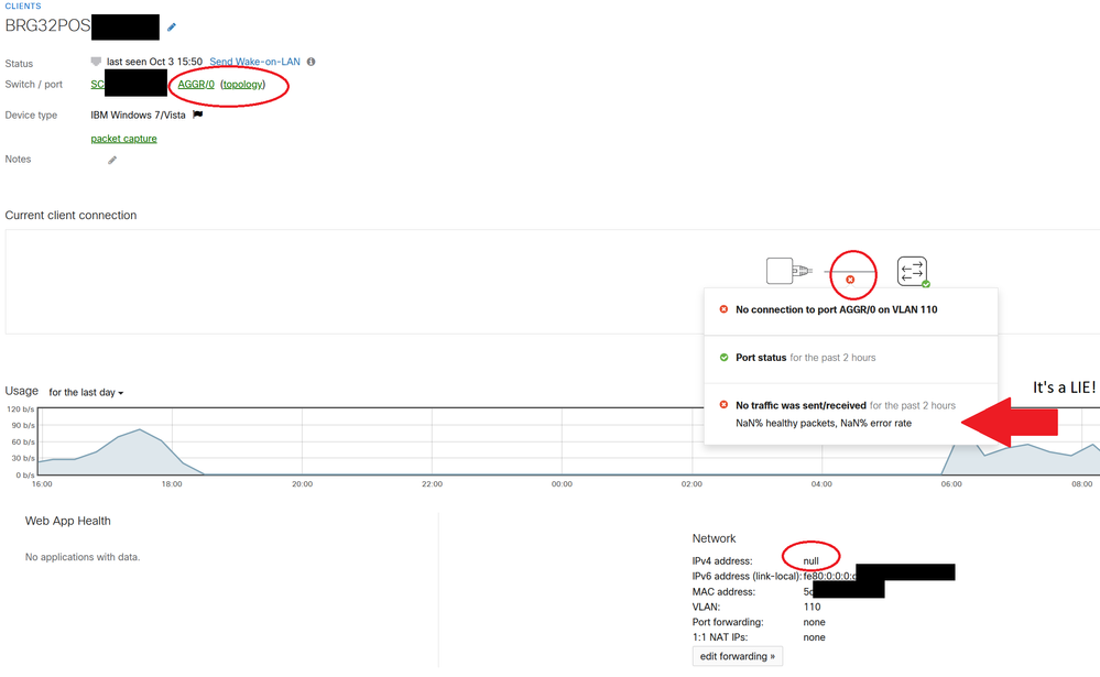

Now I've first hand experienced the problems the other customer was having.
1) Clients are ONline, but appear OFFline in the clients view.  Some fluxing between the two states.
2) Clients are reported to be on the COREswitch Aggregation ports instead of on the access switches which causes the link view of the client connected to the switch say it's offline.  And it makes it hard to track where a client is connected to yourself.
3) Clients don't seem all to have IP addresses when they are actually sending IP packets.  Or even when you use the dashboard ping feature itself.

If the clients are always incorrectly appearing on the aggregation (AGGR) port then I’d think that for some reason frames from the Meraki network to the Brocade are being reflected back to the Meraki switch again (although I’d have no idea why), and hence why you’re getting the client (which is identified by MAC address) appear on the AGGR port when it isn’t really there.

Odd things happen if you have 3rd party switches sitting in between Meraki switches. My dashboard is reporting clients connected to port 25 on a 8 port switch....
Support has said this is a known issue and they can enable a setting that should fix it.
Once again, the Brocade switches are not sitting between anything.
They are only connected to allow the old VLANs to bleed over.
However the other customer who ONLY has Meraki has the exact same problem.
