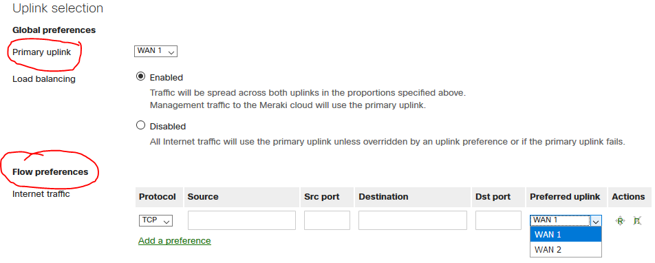

Put the space you rent out into a seperate VLAN (and hence subnet).
Use traffic flow preferences to set that subnet go out a specific WAN circuit (under Security Appliance/Traffic Shaping).

Realized I had to put "Any" in Destination instead of leaving it blank

On boarding 2 ISPs on MX 250 shall not be a challenge. All models of Meraki MXes support 2 WANs.
This can be configured from Local Status Page of the Hardware ( Connecting a PC to Management Port).
I am sure you know about this.
Now segregating WANs each for 2 different organization.
One idea shall be to take the advantage of “Traffic Shaping” Feature [Security Appliance->Traffic Shaping]. You may create 2 different subnets on MX250 and with the help of Internet Flow Preferences can route the Traffic to desired WAN.
You may configure L3 Firewall rule to deny any communication between the subnets [Security Appliance->Firewall].
However I believe if one the Link fails all the traffic shall move on to the active link.
