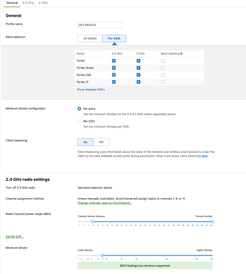

I got It, can you share your RF Profile configuration? What type of authentication are you using?
FKastro
For Authentication we are using: PSK
WPA3 Transition Mode and we have 802.11W Enabled.

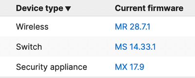

What version firmware are you running on your access points?
What models of MacBook and what version of MacOS?
Are the devices being used in a saturated environment or a cleanish one?
How are you getting the result of 80M i.e. speedtest.net?
One of the Macbooks if you hold down the option key and  click on the wifi icon what TX rate do you get?
FKastro
@BlakeRichardson
Latest Stable (Not Beta Stable) Version -
