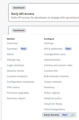

Do you have the API Early Access enabled ?
