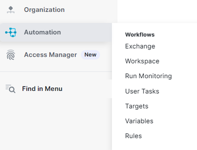

Going sideways, you should check out the new "Automation" engine as well.  I'm starting to use this instead of scripting for some tasks now.
https://documentation.meraki.com/Platform_Management/Workflows/Automation_Rules
