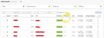

Messy
on further investigation, my above idea sucks.
I just noticed this in the dashboard...
so downtime metric DOES exist!! and there even is a download button to get the info in a csv....if I could just download those programmatically that would be great.
I cant find a relevant api endpoint tho 😞
