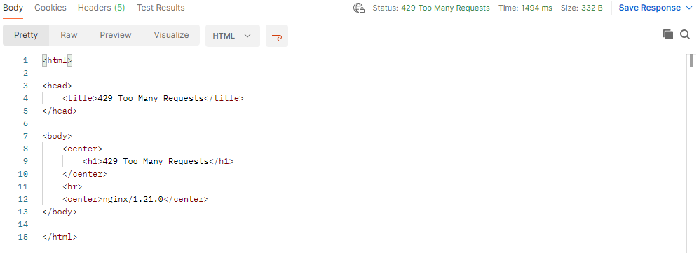

Please tell me how to solve '429 - Too many requests'.
Gwangjin
Hi,
I was collecting client information periodically using 'Get Network Clients'.
But suddenly, 'Too Many Requests' started to happen.
So I stopped all API calls and waited.
But it's been 3 hours and 'Too Many Requests' are still happening.
Even though there's only one API call.
What do I have to do to release that condition?
Let me know if anyone knows.
regards Gwangjin

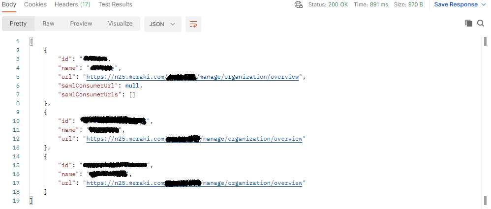

Gwangjin
I found out something new during the test.
In the company, "Too Many Requests" occurs when the Meraki Dashboard API is called.
But it's normal(status code : 200) to call the same API at home.
I think it's a restriction by IP.
Please let me know if you know what to do.
* PS : We can't change the company's IP.

Gwangjin
ShawnHu, thank you for your response.
First of all, I have something to say for sure.
  1) No one calls the Meraki Dashboard API.
  2) '429 - Too many requests' only occur in the company.
Two days later, '429 - Too Many Requests' are still occurring.
How can I solve this problem?
Again, no one is calling the Meraki Dashboard API.
regards Gwangjin
