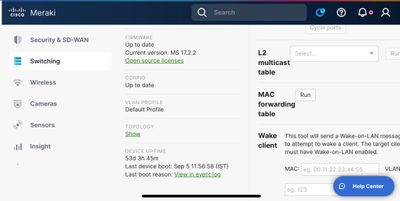

Does it show up in the ARP table in Dashboard?
DavidSack
We're on 17.2.2 on an MS 125 switch, I have been unable to locate the ARP page for the switch.
Thanks
Dave
Oren
Meraki Employee All-Star
MAC forwarding table, under tools.
DavidSack
Found it.  Was looking for ARP table, sorry for the confusion.
