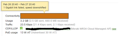

Hi,
I wonder how to monitor the status, especially connectivity of a switch port.
When I put the cursor on the connectivity bar whose color is red, it shows a message saying "Feb 26 xx:xx – Feb 27 xx:xx, 1 Gigabit link failed, speed downshifted".
What is the standard of changing color and how can I get the information of the status of the switch port via API?
p.s. I know how to get configuration of a switch port via the API(GET /devices/{serial}/switchPorts).

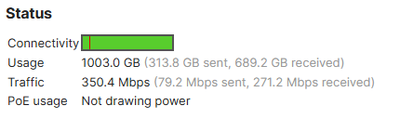

I'm using the same API but I get conflicting Traffic reporting between UI and API.
On the UI I have
while on the JSON output I get:
        "usageInKb": {
            "total"1051718192,
            "sent"329072260,
            "recv"722645932
        "clientCount"1,
        "powerUsageInWh"0.0,
        "trafficInKbps": {
            "total"99718.4,
            "sent"31200.9,
            "recv"68517.5
also I don't know the timespan to use as I want to get updates every 5 or so seconds like the UI
Any idea on what's the most recent timespan to use and why those values are different between UI and API (even it is in Mbps vs Kbps)

This might be a matter of conversion.
1Mb = 1,024 Kb (not 1,000).
1Gb = 1,024 Mb = 1,048,576 Kb.
Therefore 1,051,718,192 Kb = 1,003 Gb.
Does it make sense?
