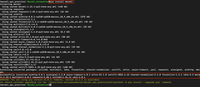

So, let’s install the Meraki library in our environment.
Another pip package I like to install is IPython. While it’s not really necessary, IPython gives a nice interface to run Python code, which leads to another Python concept.

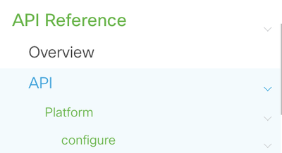

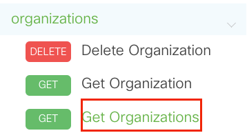

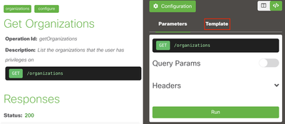

Under API reference let’s navigate to API->Platform->configure->organizations->Get Organizations.
You should be here:

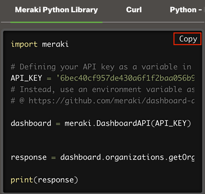

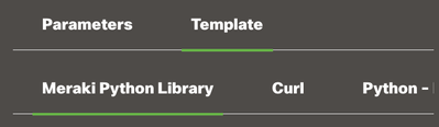

Select Template on the right:
Here you can see that you either copy the Meraki Python Library Code or the Python-Requests Library code.
Let us start with the Meraki Python Library Code.
Now paste it into the terminal with the Python interpreter running.
In the first box, you can see that immediately after dashboard = meraki.DashboardAPI(API_KEY), an API session is being established. We can see the base_url and the version of the Meraki Library being used.
In the second box, you can see two GET requests and then a 200 OK. If you have read Part 1, you would be familiar with why there are 2 GET requests and also the 200 response.
You might notice that now the prompt is waiting for you at print(response).
If you hit Enter, you will see a huge text output (we will cover this later).

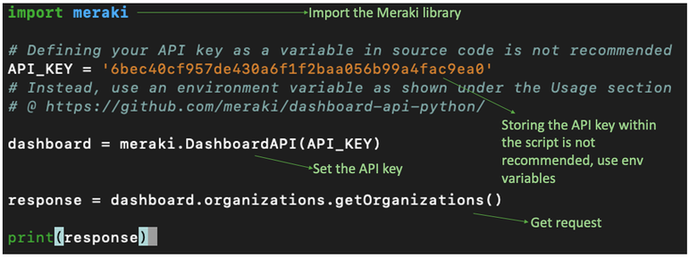

This is the code.
As you may have noticed, we do not recommend storing the API key in this manner. We are simply doing this here to make it easy to understand what is going on.
Why is this not recommended? Because if you share the code (which most of the time one does), then you have just shared your API key as well.

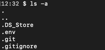

If I do directory listing and also include hidden files on my working directory:
I can see there is a .env file. What is this file? Let's read it using cat.
Ok, so I have stored the API key using a variable called API_KEY in a file called .env (the dot makes it a hidden file). By storing the API Key here, I don't have to put it in my code. Now when I do share it, I don’t have to worry about my API key being exposed.

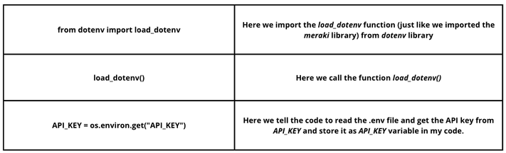

Adding these few lines will allow my Python code to get the API key from the .env file.
Let’s break this down!
If you see the previous get org’s code, we used a variable API_KEY to set the key. It is the same, but now we read it from our .env file.
