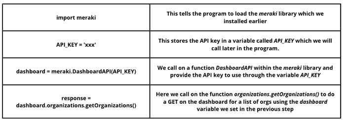

Let’s break it down!
This is the code.
As you may have noticed, we do not recommend storing the API key in this manner. We are simply doing this here to make it easy to understand what is going on.
Why is this not recommended? Because if you share the code (which most of the time one does), then you have just shared your API key as well.
