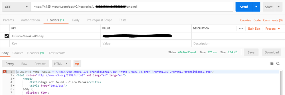

Hi all. When I make a call to the "unbind a network from a template" API, I receive an HTTP 404 response. I am wondering if anyone has used this API call or knows what the nuances are to getting it right. From the documentation, it looks extremely straightforward to make this call. It doesn't seem to require any additional information?
I have attached a screenshot from Postman showing what happens.postman - unbind api call - http 404.PNG

I think it's supposed to be a POST call, not a GET.

Did you put Network Name in API URL? (blacked-out part)
OwenStickley
Hi Kamome,
I put the network ID there. i.e. "L_<18-digit number>". Sometimes the network ID is "N_<18-digit number>".
BrechtSchamp
I'm with @BrechtSchamp , the API docs specifically state a POST operation.
https://dashboard.meraki.com/api_docs#unbind-a-network-from-a-template
OwenStickley
Thank-you @BrechtSchamp and @PhilipDAth, you were right. I hadn't noticed this is a POST, not GET method.
