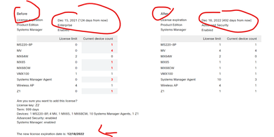

Look this example.
Should an organization enter the 30-day grace period because of exceeding device license limits, it can be brought back into compliance either by removing devices from networks within the organization or through purchasing additional licensing. The only other time an organization will enter this 30-day grace period would be if its licensing has expired by passing the co-term date. If this occurs, the only way to bring it back into licensing compliance is through the purchase of all new licensing for active devices.
For example, if an AP is added to an organization that already has five APs and licensing for ten APs, no additional licensing is required because the organization's license limit is higher than the number of APs in the organization. But if an MX series security appliance was added to the same organization, it would enter the 30-day grace period because the organization is not licensed for MX security appliances. For more information about the 30-day grace period, read the License Limit and Current Device Count section of this article or refer to the License Info article.
