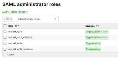

Tenant 1 also has these two SAML roles, meraki_read and meraki_write:

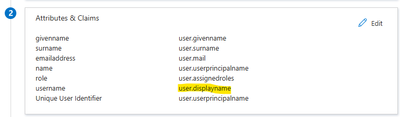

First, if you change the "username" attribute from user.email to something like user.displayName, you can log in using SAML even when there is an existing Meraki account using the email.  I do this for 100% of the SAML configurations I do.

Brian_Scheele
Changing to user.displayname was a good idea.  Implemented it and it worked.

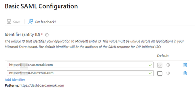

I could not reuse my subdomain and SLO logout URL that I used for Tenant 1, so I supplied different values specific for Tenant 2.  But Meraki did not like that when logging in, since that subdomain was not present in my enterprise app.  So, I added it as a secondary.

I do have separate login links per tenant, where it is https://subdomain.sso.meraki.com (substitute subdomain with what I plugged in separately for each tenant).

For permissions, Tenant 2 does have the same role names as Tenant 1, but additionally has 2 more roles specific to this tenant.  I really don't want Tenant 1 roles in there, so I plan to remove them and test again.

I think you were definitely right about the roles needing to be in both tenants.
I think I need to rethink the roles.
global_meraki_read (read-only, all tenants)
global_meraki_write (full access, all tenants)
Tenant1Write_Tenant2Read (full access to tenant 1, read only to tenant 2)
Tenant1Write_Tenant1Read (full access to tenant 2, read only to tenant 1)
Then have all 4 of these roles in both tenants.

Thanks for your help!  That was exactly the solution I needed.  While I do have 2 different login URLs, both of them actually work, since I put the second URL for Tenant 2 here:
