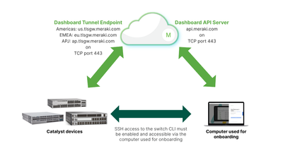

I just started to look into this whole "Cloud Monitoring for Catalyst" topic for my employer as we have some valuable usecases for some customers. As I swept through different forums I've already got to the conclusion, that the Onboarding App just won't work (conveniently) for our customer setup:
  • HTTPS proxies that perform TLS decryption are not currently supported
  • We have a dedicated, secured management environment with no connection to the internet or production / office VLANs
    • Also Switch MGMT IPs are not reachable from production / office VLANs
  • Some other smaller hurdles
Q. Would it be possible to do the onboarding of a Catalyst Switch, without the Onboarding App e.g. automate all the steps (incl. prechecks) and configurations described in the documentation  with AWX (Ansible)?
Many thanks, Aron

There's no way to onboard without the application (unless Meraki engineering have another method which is not available to the public).
That said, I'm not sure I understand the issue as the requirements for internet connectivity and TLS decryption bypass also apply to the switches and are not only required for onboarding but are required for the solution as a whole.

That's what I thought. So I'll need a Meraki employee / engineer / supporter to answer the onboarding automation topic.
We could do TLS decryption bypass for the management networks where the switches reside and deploy the onboarding software on our management jumphost but it is, as already mentioned, not very convenient for some deployments imo (see points mentioned above).

Im pretty sure that there will be a way, like with the 9800 currently not using the onboard app, but NexTunnel like other Meraki devices.
If you have a 9K switch on 17.12.x you can actually see the same commands for this in the CLI 🙂 - And they do work, the switch tries to communitate this way with the dashboard, but, unfortunatly, the dashboards denies the device because its unknown.
But , it feels like this will be the way (at some point), also for switches, and that is just great 🙂

Hey folks - we are looking forward to some action on the switching side this calendar year.  Look for information on EFT (trial) this coming summer.
Minjie_Lin
We hope to launch app-less onboarding for switches by later this calendar year.
