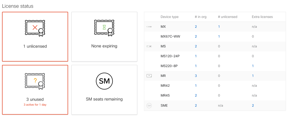

Has somebody already tried to convert to the new licensing model in an org that has MX‘s in a warm spare environment? I just did and Dashboard is yelling at me because I seem to have an unlicensed device: my primary MX from that warm spare (interestingly enough, because this one has always been licensed).

Can you show what your license page looks like

Licensing has not been an issue with the old model because of the warm spare configuration. Looks like that‘s not the case anymore.

CptnCrnch
Update:
I just called support (which is possibly what I should have done in the first place) and they were very helpful (as always).
It seems to be only a cosmetic issue within Dashboard that is currently known and will be fixed soon automatically.
Just leaving this here in case somebody else is also running into this.
