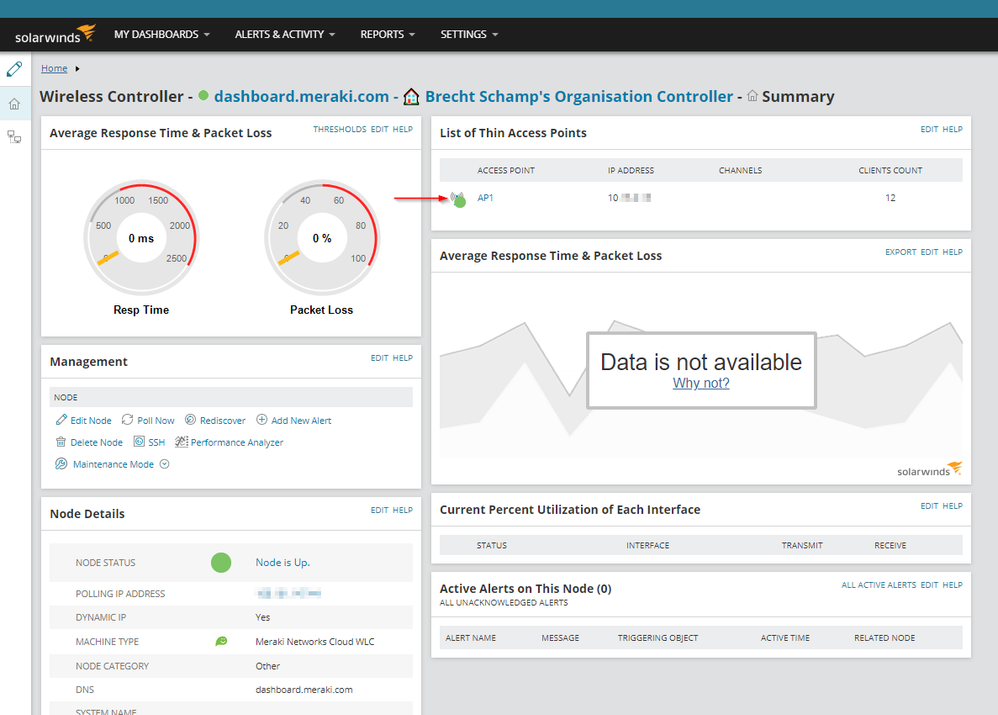

I just installed the trial of Solarwinds to give it a test. I followed the instructions and it worked fine. My AP's are showing up:
Are you sure your API key is correct?
