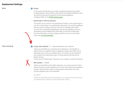

HTTPS Issue has ben solved on L3 Switch and MX -firmware issu on 17 x Ver or higher
We are using MX105 and MS 250.
had issue with firmware upgrade when upgrade from 16 x to 17 x or higher ver.
problem was HTTPS traffic got slow even with good bandwidth .
Please use Unique Client Identifier instead MAC addres as shown on screen shot.
you can find it in Security & SD-WAN --> Addressing&VLANs
