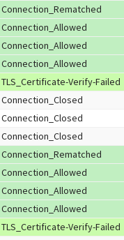

The logs l am getting from the Firewall are as follows;
Do you have any transparent proxies, or anything doing TLS inspection?

I can ping the url meraki.dashboard.com from the switch, l do not have any proxies , l have also bypassed tls inspection on my firewall. I also corrected the time which was wrong . I keep getting TLS
