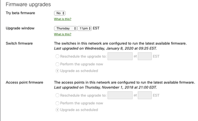

My gear is configured as the solution suggests, however it doesn't seem to be working as expected.
My APs show that there is an update available.  I got here from Organization, Firmware Upgrades, All Networks.
However, from Network Wide, General, my APs are configured to upgrade weekly.  See that the last successful run was in 2018!   I manually updated the switches Jan 8.
Lastly, if I look at the AP itself, it claims to be up to date.
Some helpful guidance is appreciated.  Thanks!

cmr
The firmware is only upgraded when the existing firmware is either warning or no longer a stable release.  If you enable betas then the same applies to replacing a beta that is no longer current with the current one.
Tim-Groeneveld
That explains it, thank you!
