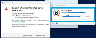

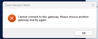

Hello,
I got an issue regarding client VPN, users are not able to connect to Anyconnect client VPN. This solution was deployed 2 years back and working fine until few days back we got this problem. upon investigation i see the Public IP in Meraki dashboard is different the one associated to meraki VM nic in Azure. I am suspecting it has been changed, Any idea what to do?, and how the IP on dashboard is different and in Azure portal associated to VM is different?
Current firmware MX 18.107.7,
I did all troubleshooting related to below issue: but i am sure its about the public IP.
