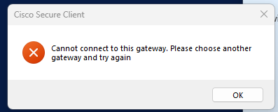

Hello,
I got an issue regarding client VPN, users are not able to connect to Anyconnect client VPN. This solution was deployed 2 years back and working fine until few days back we got this problem. upon investigation i see the Public IP in Meraki dashboard is different the one associated to meraki VM nic in Azure. I am suspecting it has been changed, Any idea what to do?, and  how the IP on dashboard is different and in Azure portal associated to VM is different?
Current firmware MX 18.107.7,
I did all troubleshooting related to below issue: but i am sure its about the public IP.

Thanks guys  @PhilipDAth  @jhoney12 @BlakeRichardson @alemabrahao for your suggestion. It has been rectified. problem was the service provider was managing both express route circuit(Azure) and newly deployed FW, and they diverted all default route from express route circuit to the FW, due to which the vMX appliance got the public ip of FW. default route was removed and vMX got actual IP(Azure provided at VMX interface) and the Client VPN gateway has started to work. It can be done by the FW IP,but that was not intended to do config in FW for this solution(managing certificates,DNS records etc)
