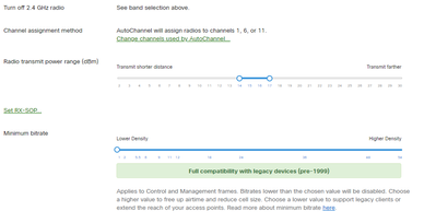

We have 33 x Meraki MR33 placed at 15 meter height from the ground in a warehouse. We are using the 2.4Ghz band with one SSID for the RF devices (Android guns and forklift terminals).
We create a new SSID with the following settings for Android smartphone son which we are using a Voip softphone
The issue we are experiencing is we have choppy calls and poor quality voice.
Could you give some clues how to optimize the calls?

15 meters is pretty close to the edge of a typical cell edge in an office environment where MR33 would propagate it signal in a donut shape.  That may be your issue, particularly for VoIP.  One possible issues you can address:
- APs at the ceiling level can see each other pretty hot and reduce TX power to adjust what it thinks is high-density deployment;  however, client devices at the floor levels are too far to use lower TX power levels;  try adjusting the minimum TX power in the Radio profiles to be no less than 14dBm (the typical max supported by smartphones)
If it doesn't resolve or improve your issue, I'd revisit proper coverage via an RF validation

The AP are used for Androids Gun, Forklift terminals and VoCollect talkman terminals in the warehouse. We are using the 2.4Ghz band for them. This is the configuration
According to the elements I have given, can you help me to establish an action plan to use the existing APs with Android mobile phones without a SIM card (I would only like to use WIFI). Knowing that the APs are Meraki MR33s located at about 15m height from the ground. We had already carried out a site survey for the installation of guns, forklift and Voicecollect terminak three years ago.

You also need to look at the capability of the devices you're using. If they can all make use of 802.11a/g/n (i.e. no 802.11b) then you should be setting a minimum bitrate of 12Mbps - this disables 802.11b which will improve overall performance of the network, which you need for VoIP (802.11b is unsuitable for wireless VoIP).
