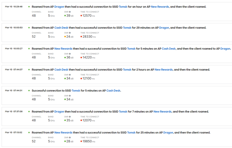

I think it does mean what you said, here is a report from a Cisco wireless phone roaming about, with plenty of red!!  It does though seem a long time, I'll have to go to the site and see if that is the real experience...

Looking at other devices it seems that:
0-5s is green
5-10s is amber
10s or more is red
cmr

@cmr time to connect is the time delay between re-association/association sent by the client and the final acknowledgment sent by the AP. Can we have a support case opened for this issue? We would like to investigate this further and get some more information that we can track internally and fix, if we identify this as a bug.

Apologies, support did reply and they said that it reflects the time between the roaming starting and the client reporting a successfully completed roam.  We found many devices report about what you'd expect with roaming around 100ms but Cisco 8821 phones reported much longer roams.  I haven't had a chance to verify that it is just a reporting issue (client or cloud related) yet, but I think that is the issue.

In terms of timing I think I have figured it out, below I was on a call walking about and had no glitches or drop out - this is shown by the red bracket.  Where I was roaming with the phone in standby the roaming is horrible - this is the lower ones.  That makes sense as the radio is kind of sleeping in that state.
