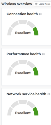

Now quite what you want, but what about the Wireless Health report?
