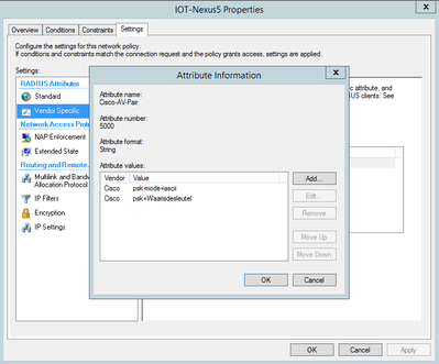

I got it working with a Cisco WLC (8.5) and NPS on Server 2012. The WLC part is pretty straight forward (PSK Based SSID with MAC filtering and AAA server configured). I know this is a Meraki forum but want to share the part of the NPS config. It might give others some leads:
NPS / Windows:
  • Create a user with its MAC-address as username an password (format aabbccddeeff). This creates an issue with the default Password Policy because it rejects the password. For testing I disabled it but this is unacceptable in production.
  • Add the user to a group (e.g. IOT)
  • Create a network policy with the condiftion of the User Group (IOT) and other favourite conditions
  • Do not select any Authentication Methods and add Vendor Specific RADIUS Attributes (Cisco-AVPair)
PSK configured on the WLC is 'Waarisdesleutel' just like the RADIUS attribute.
Caveats:
Password Policy is configured at the domain level so changing it will affect the whole domain. If you want to use NPS for this setup, install an sperate DC server with an seperate domain. Install NPS on this server and use this one for IOT-authentication.
If you want to use only one front end RADIUS server you can use this server. For normal 802.1X users you can add a policy which proxies the requests to the internal NPS server.
Seperating the IOT-users from your normal domain solves another problem and that is access to other Windows resources.
Edit : it seems in Authentication methods you need to select PAP only. My client was suddenly offline and fiddling with PAP and the "Allow clients to connect without selecting...." option got it back online. Going to keep an eye on this.

I know this is an old thread, but since so many have asked and with a recent development on this front, it is pertinent to share that IPSK with NPS is now supported on MR 30.1 and higher firmware when using both the RADIUS standard AVP Tunnel-Password AND Cisco AVPs "psk" and "psk-mode=ascii". Please see the updated documentation here: https://documentation.meraki.com/MR/Encryption_and_Authentication/IPSK_with_RADIUS_Authentication#Mi...
