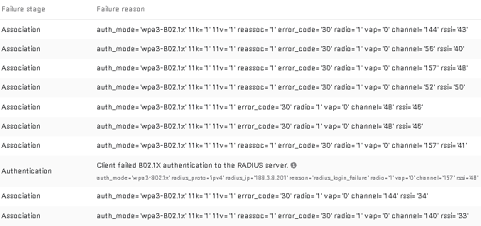

may i ask below is related with NPS server also ?
Keith_Li
checked that the problem machine wireless lan is using 802.11ax, so the 802.11w should be supported on the machine, just wonder why i still receving the auth failure ?
