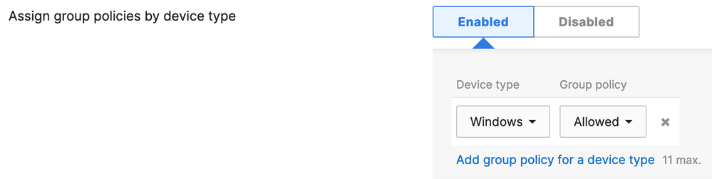

And you mentioned policy by device type was at one point configured. On this SSID if you toggle policy back on without clicking save does it show device type policies like this? If it does maybe try deleting it (click the x) then choose disabled, then save the page.
