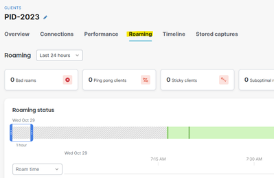

Click on an affected client, then open the "Roaming" tab to see what it says.

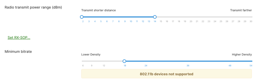

Hi @merman01 ,
"... the nearest wap is being advertised but the devices are disconnecting from other WAP".
The decision which AP to connect to is completely made by the client. If, the Wireless clients are connecting to APs further away. I would suspect they are transmitting their RF signals too far. Have a look at adjusting the power levels and minimum bitrate. This can be done in the RF Profile.
See below guide for details.
https://documentation.meraki.com/MR/Troubleshooting_and_Support/Troubleshooting/Wireless_Issue_Resol...
