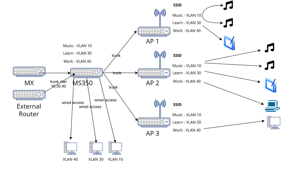

I am just unboxed my MS and MR devices and I am very new to Meraki.
I want to apply my network with the following topology :
I have 3 vlan 10,30 and 40 which works fine on wired connection, connected onto MS350. The DHCP server is the External router.
I have 3 SSIDs and I want each SSID have different VLAN: Music is VLAN 10, Learn is VLAN 30 and Work is VLAN 40.
Would you please to guide me in how to :
1) have SSID with each VLAN as my plan?
2) how to enable Multicast traffict/IGMP only for VLAN 10 both wired and wireless.
Regards

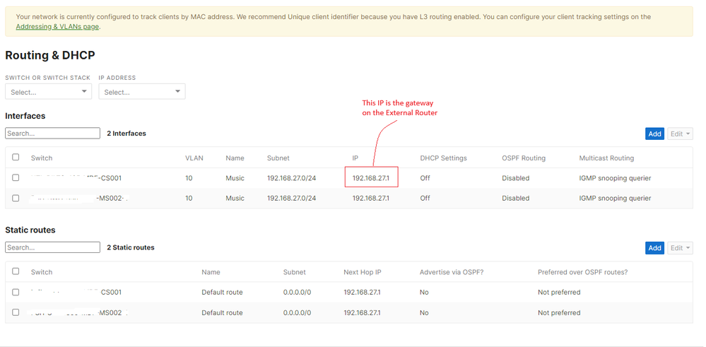

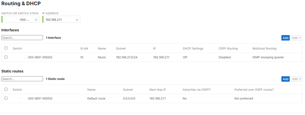

For IGMP, I did as follow :
IP address I am using for multicast is 192.168.27.0/24 and the DHCP is generated from External router
This is the view of MXThis is the view of MX
The view on MSThe view on MS
Please correct me if I am wrong since I do not know what the next step is. And how to test if the multicast traffict is now working/not. Thank you

Can you clarify the reason(s) for having the different SSIDs?
wial
Comes here often
We have a music controller needs connect to the network wirelessly, network is on vlan 10, no internet, this why I put on different ssid.
same thing for ssid learn, it has to connect to our local learning management system in vlan 30. Students can access this wirelessly.
SSID work is for public internet.
