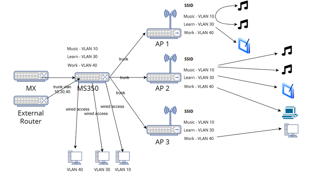

I am just unboxed my MS and MR devices and I am very new to Meraki.
I want to apply my network with the following topology :
I have 3 vlan 10,30 and 40 which works fine on wired connection, connected onto MS350. The DHCP server is the External router.
I have 3 SSIDs and I want each SSID have different VLAN: Music is VLAN 10, Learn is VLAN 30 and Work is VLAN 40.
Would you please to guide me in how to :
1) have SSID with each VLAN as my plan?
2) how to enable Multicast traffict/IGMP only for VLAN 10 both wired and wireless.
Regards
