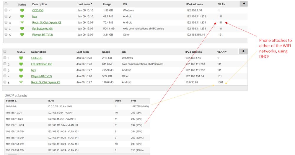

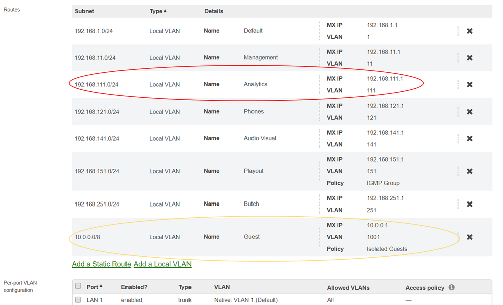

I am re-configuring my test network and an unexpected error has occurred. I am in the first stage of moving devices to appropriate VLANs. The VLANs  used by the two SSIDs are circled in the screenshot below -
The phone attaches either of the SSIDs as selected -

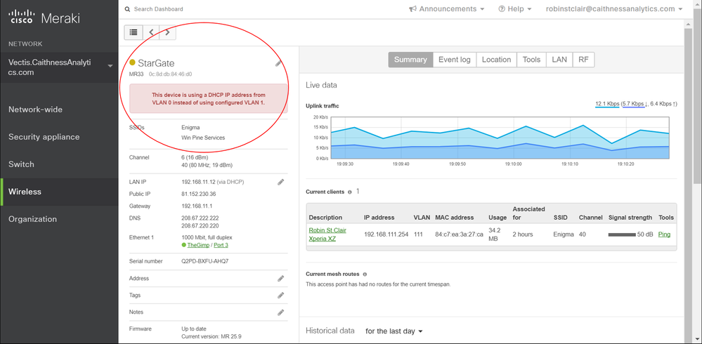

However, the Access Point is reporting an error -
Doubtless, I've done something silly, but I am a little surprised at the mention of VLAN 0.

Have you tried getting the phone to release and renew its DHCP address?  It may be holding onto its last lease assignment.
Uberseehandel
Philip
Thanks for your interest.
I just tried getting the phone to forget both networks so it was unattached and then re-attached to VLAN 111 Analytics ( via the Enigma SSID. I still get the same error message and the orange status on the AP.
The default is VLAN 1 not 0. The switch and the AP are on the management VLAN 11. Eventually, I intend removing VLAN 1 and I do not see that I need VLAN 0 (is that a normal VLAN), if everything is specifically assigned?
I'm a bit puzzled.

My assumptions are that the error message is for the AP not the phone. How's the AP configured, is it configured to receive an IP address via DHCP? Make sure there is no VLAN tagging set on the AP's DHCP configuration as I assume it's already being tagged at the Switch port? (Double tagging could cause this error message)

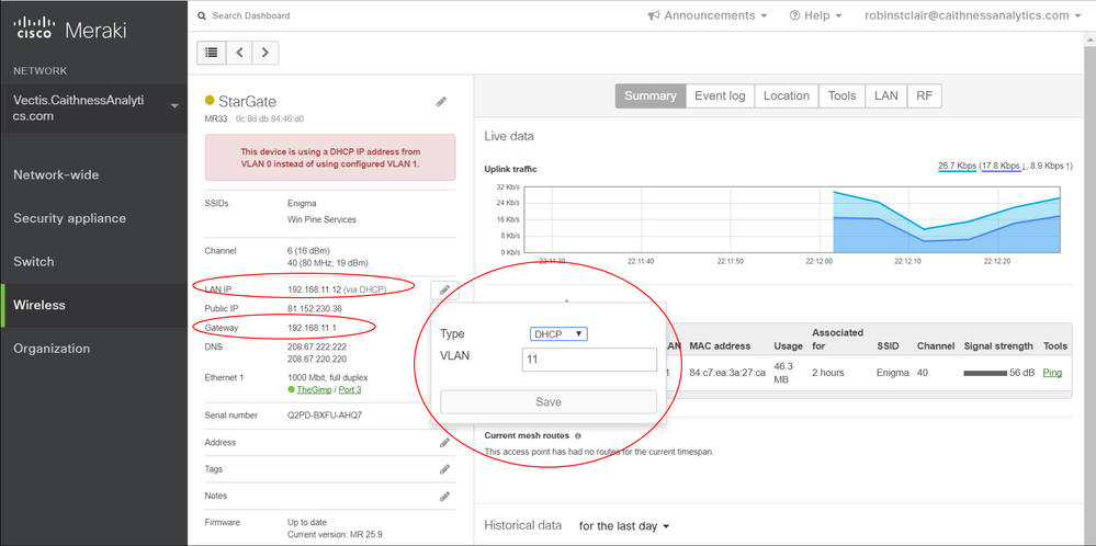

Thanks for your suggestion - the screenshot below shows how the AP is configured -
Both the SSIDs function as expected. The AP is getting its IP address from the correct VLAN DHCP server. I am not sure where to go looking for more causes . . .

Try checking the config on the local status page.  Particularly the VLAN assigned there.
If it all still looks correct perhaps give the AP a power cycle.
To me, everything looks configured correctly.

I've accessed the local pages for the switch (MS220-8P) and the AP, everything appears to be Healthy.
However, I check the entry on the switch port page and it shows that that the port the switch is connected to has
Native VLAN - 11
Allowed VLAN - 11, 111, 1001
(11 Management, 111 Analytics, 1001 Isolated Guests)
- is this correct?
Robin St.Clair | Principal, Caithness Analytics | @uberseehandel
You have two choices:
1. Configure the native VLAN configured as "1".  Nothing will use it, as you have everything configured to use other VLANs.
2. Leave the native VLAN as 11 but change the AP backup to using VLAN1 - which will actually end up on VLAN11.
Sorry this is between the switch and the MX.
I would make the native VLAN "1", and configure the switch to use VLAN11 as its management VLAN via the local status page on the switch.
MilesMeraki
Head in the Cloud
Double tagging is the issue here. As @PhilipDAth has stated, the Native VLAN is 11 and the AP is using VLAN 11 for it's DHCP requests when the Native VLAN is already VLAN 11.
As @PhilipDAth has mentioned, change the Native VLAN back to 1 and this will resolve the issue.

As you both predicted, changing the native VLAN for the AP(s) back to 1 solved the problem.

If you want the AP to be on VLAN 11 and the switch port to use VLAN 11 as it's native (or untagged) VLAN, here's what you should try.
Set the AP to DHCP and leave the VLAN tag blank.
Then set the switch port to native VLAN 11.
Then bounce the port.
If the AP's configured management VLAN matches the native VLAN on the switch port you will get this error.
The AP doesn't have a way of knowing what native VLAN the switch is configured for. In this case, it just knows that it's configured to use DHCP on a VLAN that it never gets traffic with the expected VLAN tag from the switch.

Since the AP is configured to use VLAN11, the port it plugs into on the switch should be a trunk port, and it can use a native VLAN of 1 (make sure the switch is not using a native vlan of 11).  Make sure the switch port that connects to the MX is also a trunk port.  Is this a Meraki switch?
