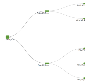

We use a RADIUS server for MAC-based authentication, but users are facing frequent SSID disassociations that hamper productivity. Since our RADIUS is configured strictly for AAA (not for automatic disconnects) and the connection to the external server is stable, we cannot determine if the disconnects originate from Meraki, the client device(multple client facing same problem), or the RADIUS server.
Meraki Hardware-
MX85    -2 (HA)
MS130  -2
MR28   -5

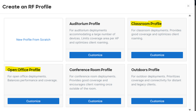

The first thing I check these days is whether the customer has an "RF Profile" configured.  It solves about 90% of the issues immediately by creating one.
https://documentation.meraki.com/Wireless/Operate_and_Maintain/User_Guides/Radio_Settings/RF_Profile...
I mostly use the "Open Office Profile".
Make sure you make the profile the "default", or apply it to all your APs.
And while you are there, make sure you turn on AI channel planning and "busy hour".
https://documentation.meraki.com/Wireless/Operate_and_Maintain/User_Guides/Radio_Settings/AI_-_RRM
