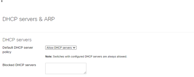

Hello,
I have checked config and everything is proper also there is no DHCP blocking
PFA snap for reference 🙂

Without understanding your topology better I can just keep guessing. Have you tried a packet capture to see where DHCP is failing? Have you contacted support? Since it seems an easily reproducible problem it shouldn’t be too hard to track down through basic troubleshooting steps.
