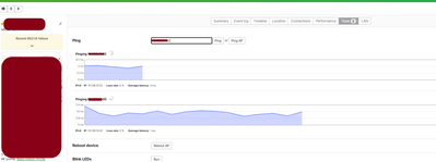

The next step is moving this DHCP on one FW to other FW
For testing i moved one AP but i got this resoult
As wll i cant see in the box the radius ok .
like this
