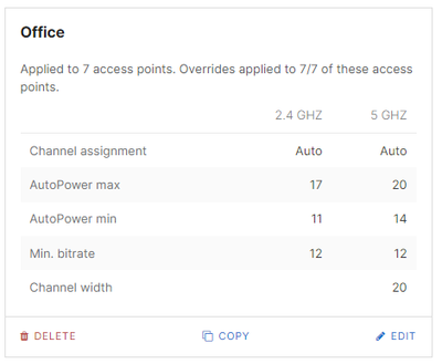

These are pretty safe settings to use for a dense indoor deployment.  I usually start with these numbers and then take it from there.
