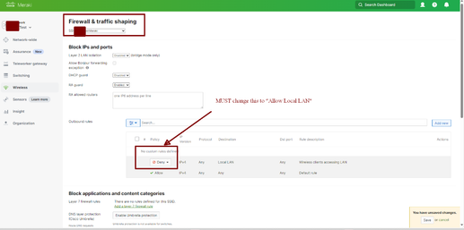

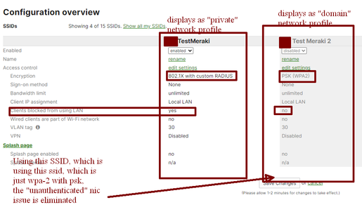

Only bug is the windows nic says "Unauthenticated." It's on the correct vlan and it has network access.
What would cause this? The only thing I can think of is that I have not configured a "proper" (ie, from an enterprise CA) certificate for the NPS server. The NPS server does have an issued server cert from our standalone windows CA (we don't have an Enterprise CA yet). It does not seem to matter whether or not I click "Validate Server Certificate" on the gpo settings for the wifi profile. See below:
