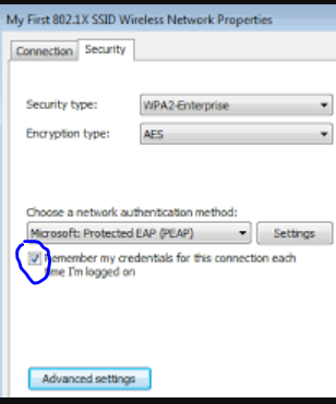

users are part of the the domain (active directory) once they are login in to they PC , they should automatically connected to the ssid wit encryption 802.1x with custom radius , but they have to enter they user name and password to be able to connect on the ssid , that s what it is happening .
Check if this option is enabled.
The best way is to enable single sign on for the WLAN. If you are on a new Windows release you perhaps have to disable Credential Guard for this to work. Using client Certificates would be the better option. And all these options are ideally pushed with GPOs.
