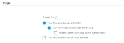

Good Morning, Just wondering if anyone has managed to setup radsec between Meraki APs and Cisco ISE. I'm certain I've setup both environments correctly, but authentication (pass or fail) isn't showing with the ISE logs, so suspect it's an issue with the radsec initial connection. When importing the Meraki certificate into ISE, which service should this trusted certificate be used for? (See below)

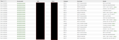

Logs in the Meraki AP when trying to authenticate via radsec:

@DevOps_RC I would have thought it is the bottom one as the Meraki APs should count as Cisco services, but I am not 100% certain.
